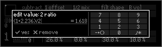

  • Added support for arithmetic (with more than 1 operator) in the number input menu: golden-ratio-sum
