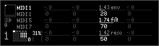

Note that I have not been able to update the manual yet so here is a short guide.
  • The middle column of the numpad sets the output type: MIDI or MPE.
  • The right column of black buttons on the numpad sets the MIDI channel or MPE zone.
In this example 3 parameters are used. They are all sending on MIDI channel 1 and their CC’s are 43, 74 and 42. The pulses are sending MIDI on channels 1, 5 and 7.
To change a parameter’s MIDI CC, channel and label hold [edit] and press on the corresponding encoder. You can give a parameter a text label as a reminder what it controls. Each parameter can send on a different MIDI channel or the channel can be set to 0 so that it is disabled and does not send unnecessary MIDI messages.
edit: the manual is now updated with more details: External - PolyPulse manual

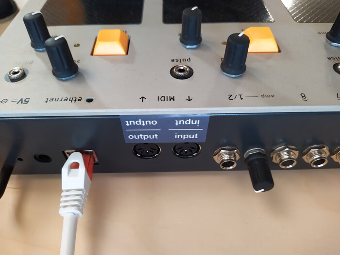

The external sound engine should work if both devices have the same channel, but some devices use the channel numbers 0-15 while others use 1-16 (which the PolyPulse does). I searched online and it seems the TD3 should be able be played using MIDI.
Maybe also check if the MIDI cable is in the correct port, the output is the connector on the right, next to the ethernet port.

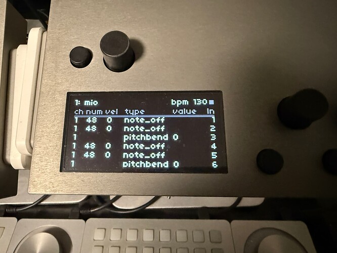

I just can’t get MIDI OUT notes to work.
I tried multiple devices and even tried different MIDI channels.
I even hooked up my norns and ran a MIDI MONITOR to see what the PolyPulse is sending.

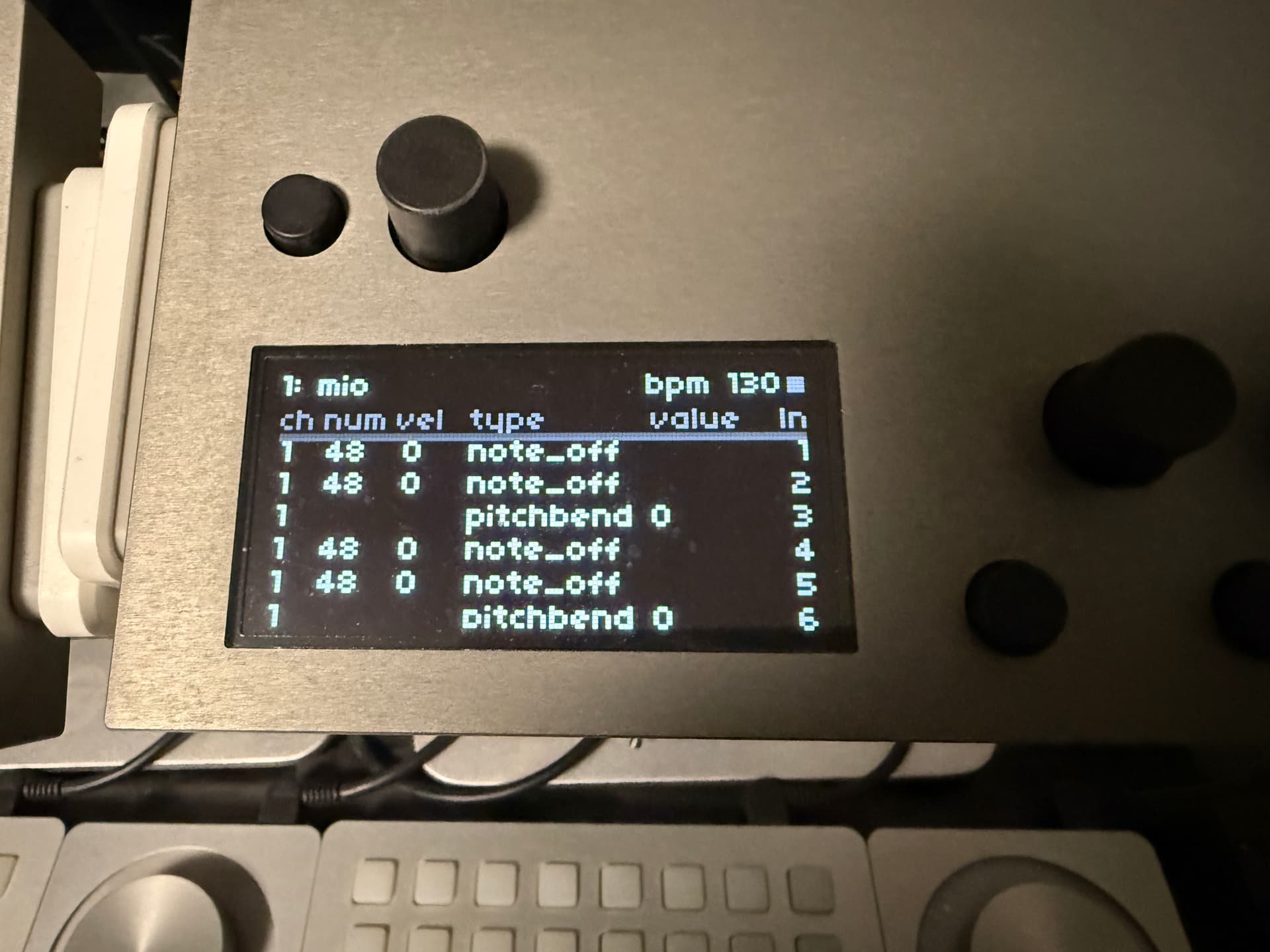

Here is what the MIDI Monitor shows from the PolyPulse.
There doesn’t seem to be any note ON info.

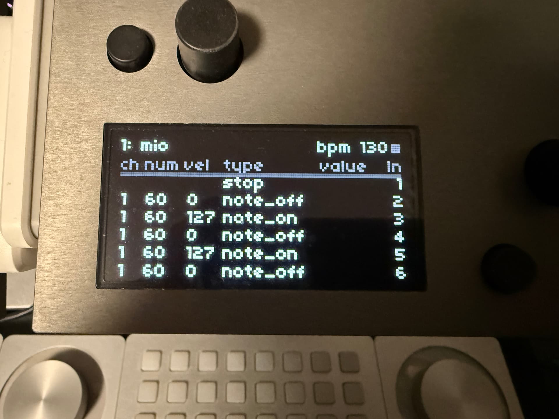

And here is the info from the Cirklon…

It looks like all notes that are sent are with velocity 0 (that the norns monitor interprets as note off). I think min velocity (0) and max velocity (127) are set in such a way that all the MIDI notes are sent with velocity 0.
Can you try opening track settings with [edit]+[track] and then setting:
  • min velocity (0) to -48 dB
  • max velocity (127) to 0 dB
