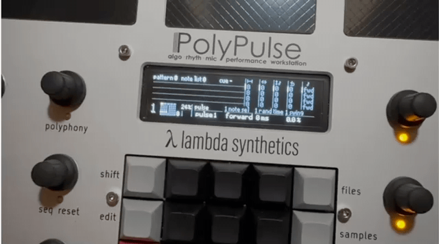

**when I load a file, pp repeatedly crashes se Video
I can’t seem to get the video to play…
