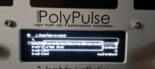

I get an error message when saving/overwriting a file, but the file is written (created/updated) even if this error message occure.
It happens since i loaded the 0.1.30 firmeware version.
I’ll post a video
I’ll post a video
After investigating it’s not related to 0.1.30 firmware version, it looks this error message is because you need at least one note created in the “note list” when you are using sample list. If there is no note inside the “note list” when you save your project with “sample list” in it, then you get that message error
The error indeed is caused by all note lists being empty.
Fixed for next update!
