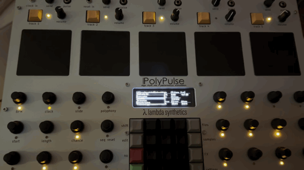

Once in this menu it was impossible to get out of this menu, also a shut down was impossible - I had to pull the Plug
I often tent to have Problems to get out menues is the way out or escape variable depending on the properties of a specific menu ?
Could you post a photo of the menu? The video is too grainy for me to read any of the text on screen
Menu’s like the one shown in the video can be exited/cancelled by pressing [no]
It would help if you post a readable picture so I can understand where the menu came from.

I’m having the same issue. I can’t exit the edit note list by pressing no and have to pull the plug.
So I tried to reproduce this issue with the Edit note list menu getting stuck. It seems to only happen when one of the track buttons are pressed. Then it closes the note list editor without closing the menu (which gets stuck without the editor)
I’ve included a fix for this in the next software update! For now don’t press the track buttons when the ‘Edit note list’ menu is opened.
Let me know if this sort of thing happens with other menu’s.
