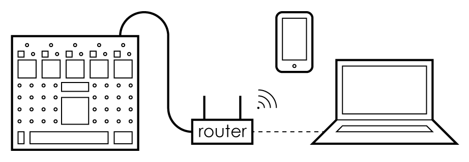

If you are connected like this:
The router should assign unique IPv4’s to all devices connected, including the PolyPulse. You should also get a IPv6 that starts with fe80::….
If the PolyPulse shows this:
ethernet IPv4 192.168.1.1
ethernet IPv6
then there is no working connection to the router or the router is incorrectly configured. Perhaps try using a different ethernet cable.
