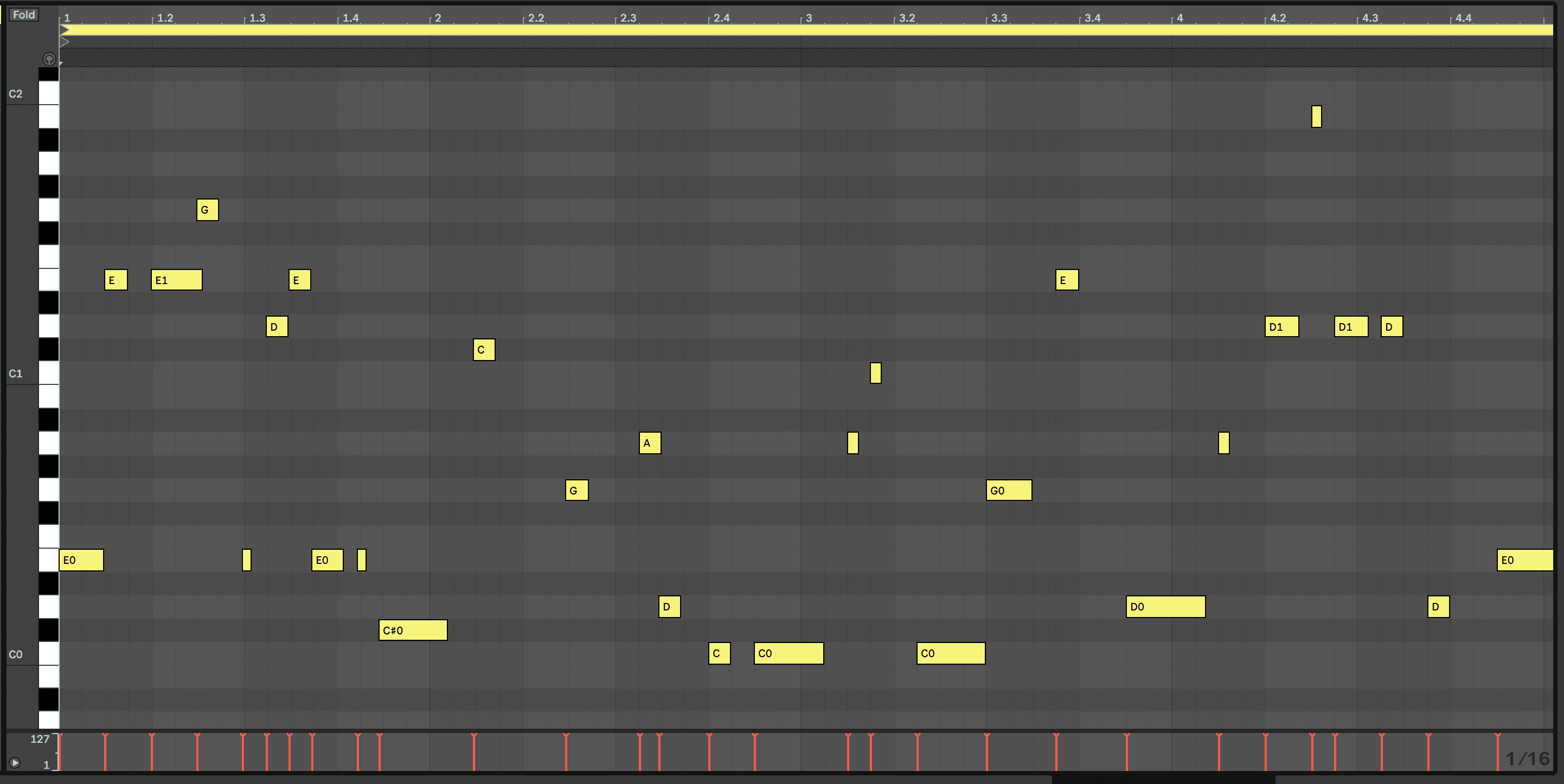

Resaon I am inquering is; let’s say we want to recreate the something like the Bass line from Daft Punk Voyager
How would I recreate this on the PP? Whereas notes are played at different resolution intervals and have different lengths …( and this is a real bassist, so ideally I’d like to shift some keynotes a bit off the grid) …
I mean is it a case of a: 32nd note pulse and entering a 4bar note list full of rest and ties? Or can this be done with some sequence trickery /resets and offsets?

So to fully recreate a sequence such as the one you pictured might prove tricky or unpractical. The note list system has pitch and velocity but does not have note lengths or timing/rhythm.
You can indeed create rhythms in a note list by adding multiple rests in the note list but this will might be a bit unpractical in comparison to just using a conventional step sequencer or piano roll.
This is not to say you cannot create fun / cool patterns and melodies on the PolyPulse. Its just that the PolyPulses approach to sequencing is quite different from step sequencers / piano rolls and so it has its own strengths. Its like how some parts composed on a guitar just don’t really work well on a piano and likewise.
