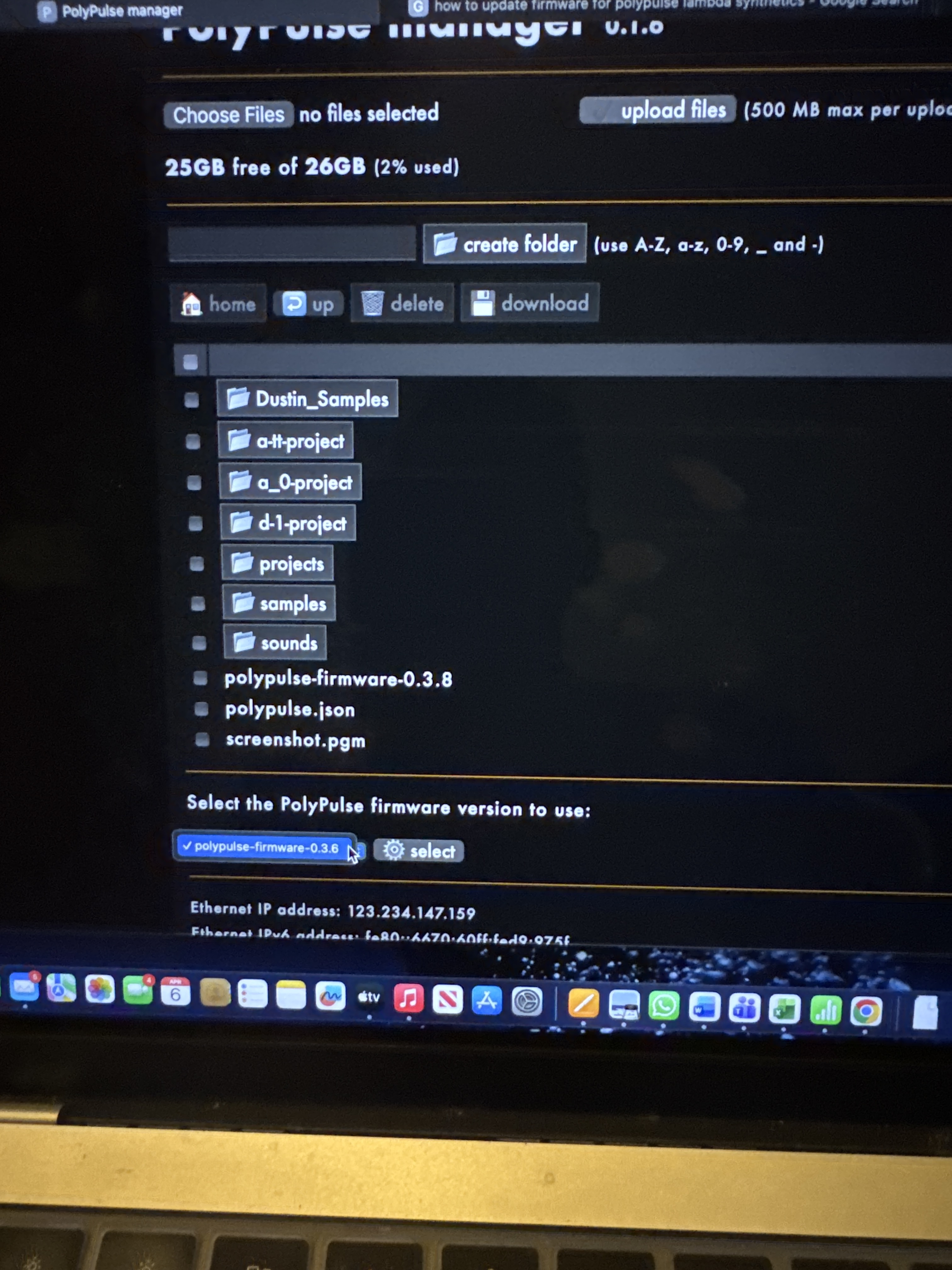

I have a network connection to the PolyPulse Manager. I have downloaded the 3.8 firmware but all the Managers sees is 3.6 firmware.
I have been able to upload a ton of samples and I see those in my files on my PolyPulse so the Manager is working with the PolyPulse.
Any suggestions around what I am missing?

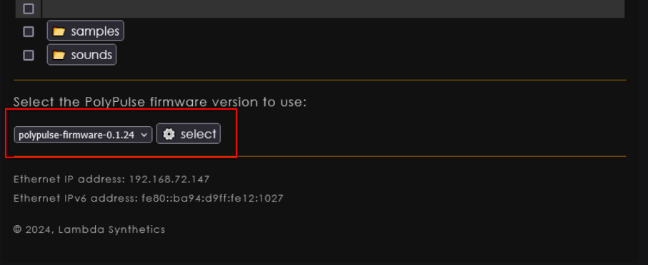

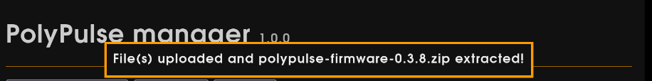

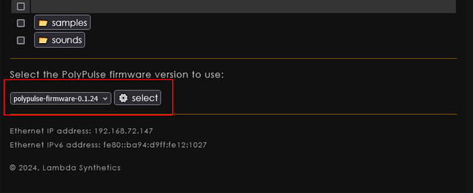

When you upload a firmware zip, do you see this:
And then it is not in the dropdown list?
Hi Ward,
I can upload the file but the zip file is not extracted.
Make sure the name of the firmware zip you download from the forum is unchanged. It has to start with polypulse-firmware- and end with .zip, otherwise the PolyPulse cannot distinguish it from any other zip archive or file. By default the firmware updates I post on the forum have that name, but possibly you or your computer/browser change it.
Got it, thanks again! I had to change a browser setting like you suggested.
