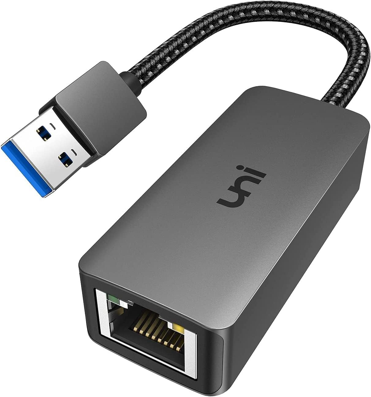

My studio doesn’t have real internet. I use my phone as a hotspot, and plugged a USB-to-Ethernet adapter into my MacBook. Hammered away at it for ages, but couldn’t connect to PolyPulse. Is there a preferred adapter for doing this kind of thing?
I bought this one and couldn’t make it work:
My connection attempt was with the firmware just before the current one. I finally put Polypulse in my van and drove to the nearest ethernet cable. Which worked fine, of course- updated with no trouble at all.
I think the usb ethernet adapater looks fine. Can you check in network settings if it shows up / is detected by the computer under system preferences → network? On the left you should see a list of devices. In that list there should be a network called something like ethernet adapter USB 100/1000 LAN.

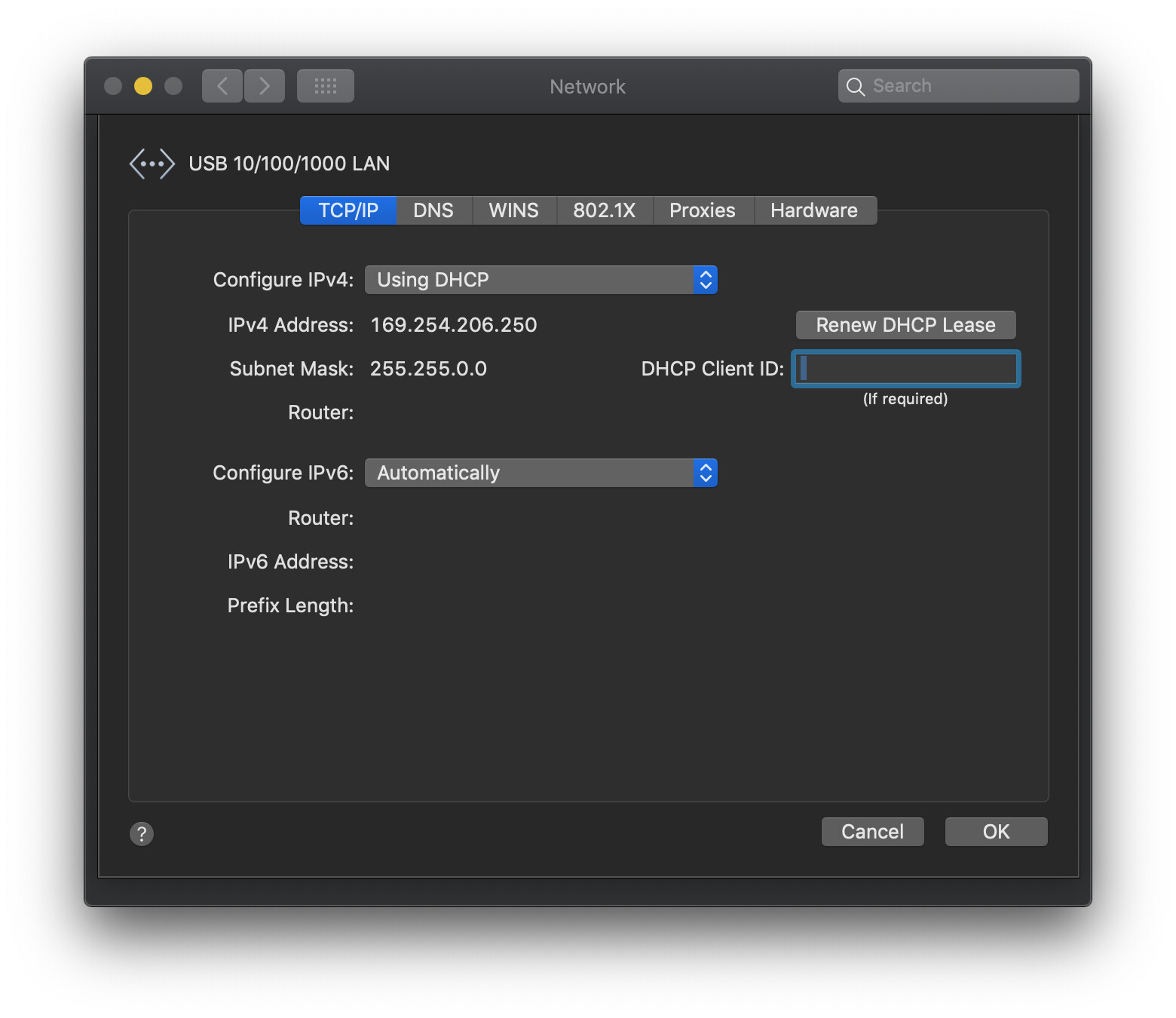

Can you post a screenshot of the mac network settings of the USB ethernet adapter?
I don’t have a mac laying around here so I can’t look for myself
Looks like Polypulse has IPv6 but no IPv4, and the USB dongle has IPv4 but no IPv6.
So your USB adapter is fine!
Try this on the PolyPulse:
IP assignment: static
ethernet IPv4: 169.254.206.200 (press edit to type new value, use the same numbers as your computer up until the last dot, then use a different number between 0 and 255)
Then restart the OS: [edit]+[settings] → shutdown PolyPulse
After about 10 seconds, remove the power cable, wait a few seconds and put the power cable back in.
Then in your browser type in the IPv4 value as used above for the PolyPulse
That worked, once I realized that I’d unplugged the USB dongle at some point and it had switched to using a new IPv4. So I went through the process on PolyPulse again and it’s finally connected.
For the next knuckle-dragging Neanderthal who has this problem: to change the IPv4 on PolyPulse, you have to switch from ‘static’ to ‘dynamic’ and back again before you can type in a new number.
