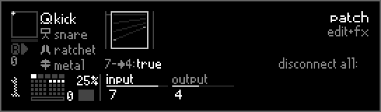

So to connect the quad engine parts to output 1/2/3/4 you need to set the following connections to true:
1 → 1
3 → 2
5 → 3
7 → 4
Then it should look like this:
Does that work for you?

That’s what I did, but it was behaving the way I explained on the message. I have tried to “true” every single output with just one input and I didn’t have the same result
kick to output 1 it’s ok but If I send it to output 6 : no sound. And If I send it to output 8 : I have sound even if I havent connected any cable…
