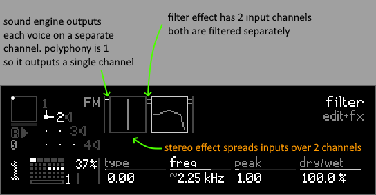

So what I think is happening here is:
  • After the sound engine the first effect in the chain is stereo. Without this effect you would only hear a mono synth on the left speaker so I wouldn’t remove it.
  • Then comes the filter. Because the stereo effect outputs 2 channels the filter filters 2 channels.
screenshot
The LFO is assigned to the filter freq. Because modulators are polyphonic/multichannel it can happen that the LFO’s of channel 1 and channel 2 are not at the same position or out of phase. Maybe on channel 1 the LFO goes downwards while on channel 2 it goes upwards: now it sounds like it is panning!
There are two solutions:
  1. Change the order of the effects to: sound engine → filter → stereo. Then the filter only filters a single channel and thus the ‘panning effect’ goes away.
  2. Set the LFO’s trig parameter to note. Both LFO channels will reset to phase 0 when a note starts so they are synced and the ‘panning effect’ goes away. (this only works if the sound engine’s polyphony is set to 1)
To put the filter on a different place you have to remove it and then add it again at a different position. When adding an audio effect after choosing the type you can set where it is inserted using encoder X and then pressing [yes] to confirm.

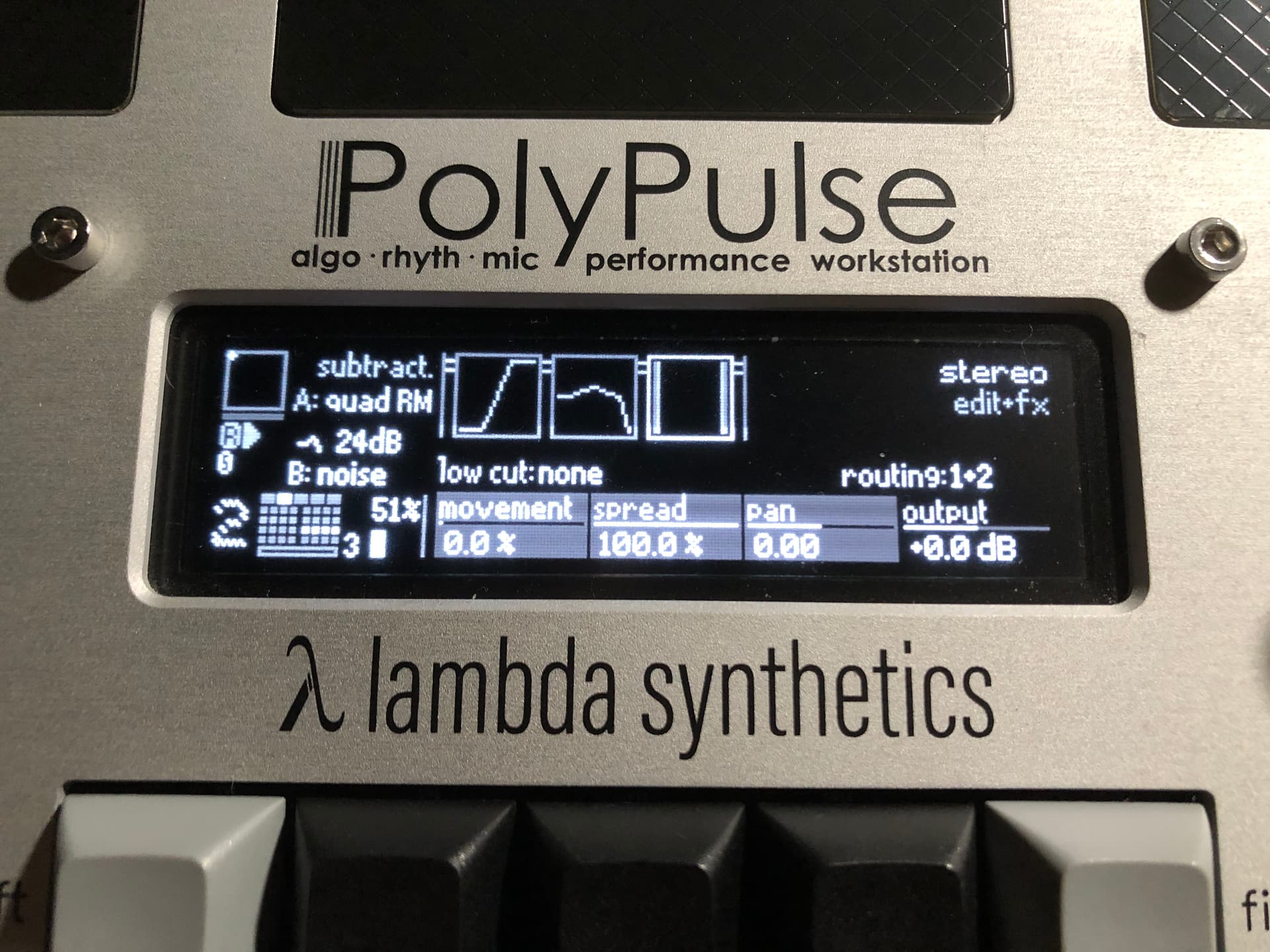

I double checked, and there is no LFO assigned to the default filter on the subtractive engine and for sure the new filter effect is routed BEFORE the stereo effect on the channel effects.
For clarity, In this photo we can see that the stereo effect is routed after the filter in the FX chain.
Thanks for the photo. It seems like you are triggering two voices using unison?

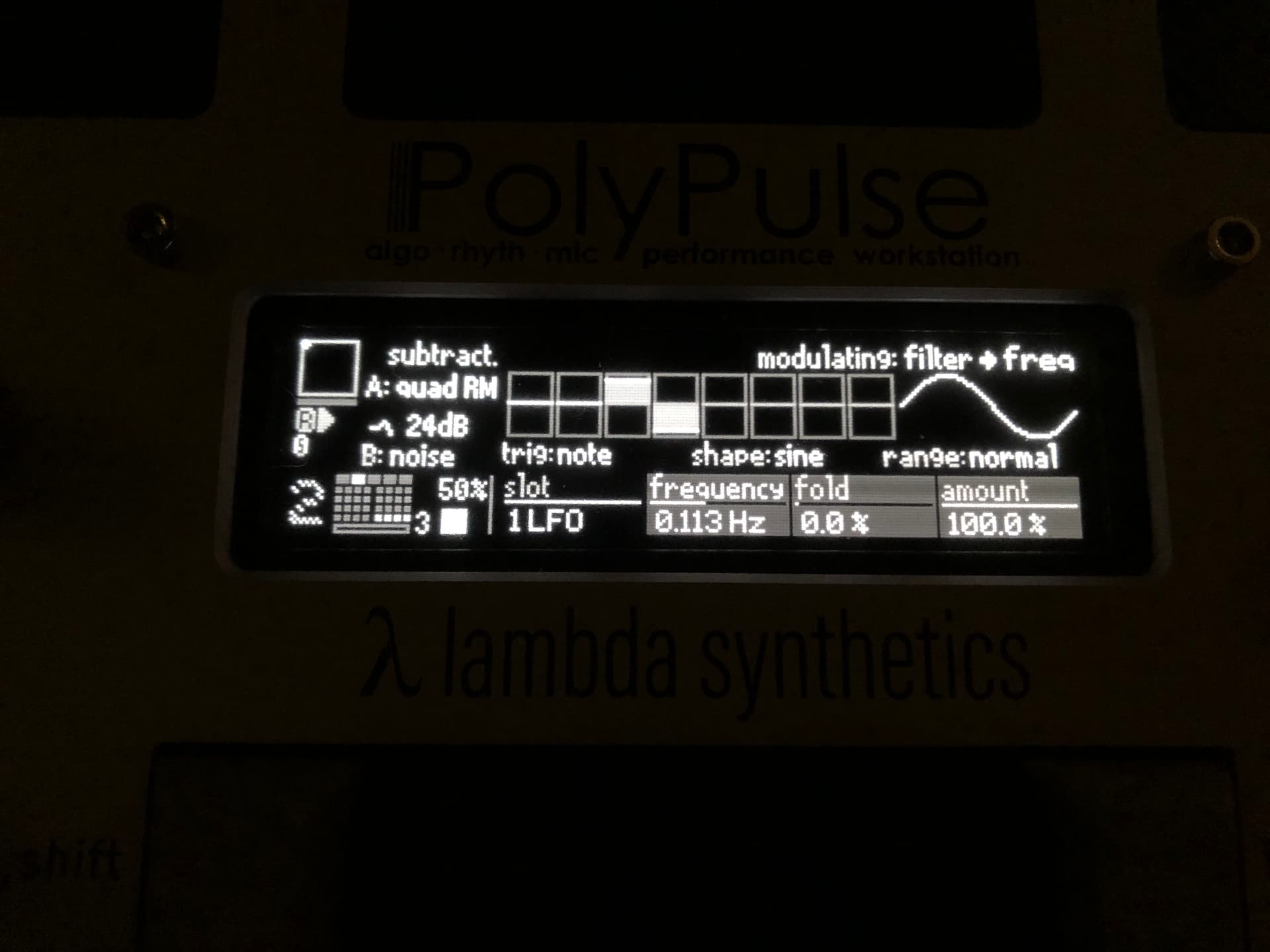

The issue of using a trig set to NOTE mode for the LFO is that the LFO no longer works.
I’m just trying to have a slow moving free LFO on the filter cutoff.
NOTE mode resets the LFO everytime a note is triggered, which defeats the purpose of what I’m trying to do.
Here’s a photo of the LFO set to NOTE mode - but now you don’t hear the LFO moving the filter cutoff like I’m trying to acheive.
So assignable modulators are only moving/active when sound is actually playing. Maybe they start moving again when you press a key on the keyboard? I don’t have a PolyPulse in front of me right now so I can’t check.
If however the LFO is also not playing when sound is playing then that is definitely a bug.
Ah right I understand. Then for now I’m afraid there is no solution.
I will put both syncable LFO’s and the option to choose between multi/poly modulation (current situation) and single/mono modulation (which would solve the panning issue) on my to-do list.

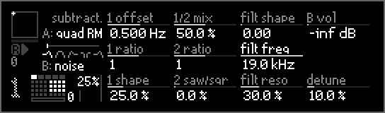

I still have some Q about the screen display ( I dont remember this being in the manual, but maybe wrong
A: Quad Ringmod- B: noise where do I Go from here to change those A & B

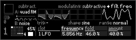

What are the informations in the squres 2 rows of 8 ? Are the for the slot LFO only ?
So subtractive has three options controlled by the top row of black buttons on the numpad:
  • top left button: sound source A which currently has only one mode (quad RM), therefore pressing this button does not do anything.
  • top middle button: filter type (12dB svf with variable shape / 12dB lowpass)
  • top right button: sound source B (noise / sample list)
synthesis-subtractive
So these 8 rectangles show the modulators movement. Because the modulator system is polyphonic/multichannel there are 8 plots because each track has a max polyphony of 8. As the synth in the image below has polyphony set to 4 and 4 voices are playing you see only 4 plots filled with the LFO:
per-voice-lfo
Modulation can be bipolar so there is a horizontal line in the middle at 0.
